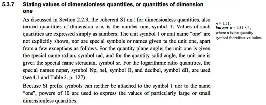

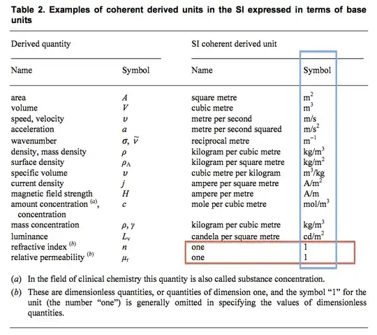

Straight from the horse's mouth:
Source: Bureau International des Poids et Mesures (Search for "dimensionless" for all guidelines.)
The International Bureau of Weights and Measures (French: Bureau international des poids et mesures), is an international standards organisation, one of three such organisations established to maintain the International System of Units (SI) under the terms of the Metre Convention (Convention du Mètre). The organisation is usually referred to by its French initialism, BIPM.

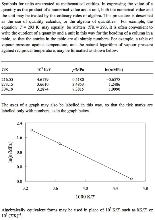

EDIT: I also see the style Emilio Pisanty recommends, particularly in tables and graphs. For a graph, the idea is that the datapoints you are plotting are actually numbers, so you want to divide them by the relevant base units. That then scales everything so that your plot fits on the page. As an example, you might plot force vs displacement to measure a spring constant. The x-axis would then be $x/\text{m}$, and the y-axis would be $F/\text{N}$, and both would be dimensionless. You could also use SI prefixes if that were useful.
The same idea would apply to a table. For your example, you would have it as Length / m || Force / N || Safety Factor || etc. Again, you can add SI prefixes to keep the actual numbers in the table easy to read.
Additional EDIT (by Gugg) with "official approval" and an illustration of this style:
BIPM

An alternative is to use the (slightly) more formally correct convention Length/m and Force/N for the first two, in which case simply using Safety Factor will work.
