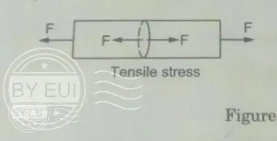

I read in my book that if we have a rope which is being pulled on both sides by a force $F$ , then the stress at any cross section of the rope is defined as $\sigma = \frac{F}{area}$
. enter image description here
But my question is that since the rope is pulled from both the ends, the molecules of the considered cross section is being pulled by other molecules from both sides of the cross sections.
So the stress is due to both the forces.
So shouldn't stress be defined as
$$\sigma =\frac{2F}{area}$$
Edit : The answer of Bob D forces me to add an edit. By $\sigma = \frac{2F}{A}$ , I meant to say
$\sigma =\frac{|F_{left}|}{A}+\frac{|F_{right}|}{A} = \frac{2F}{A}$ .
Here $|F_{left}|$ and $|F_{right}|$ are the forces applied by molecules on the left and right of the considered cross section on the cross section.
Hope it is clear now.

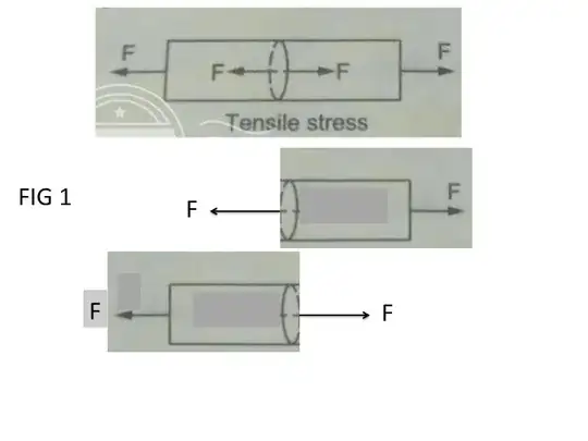

But my question is that since the rope is pulled from both the ends , the molecules of the considered cross section is being pulled by other molecules from both sides of the cross sections.
True the molecules of the cross section are being pulled by the molecules of from both sides of the cross section. But the force on both sides cross section have to be equal and opposite as shown in your figure and in the free body diagrams of each side of the cut section in my Fig 1 below, otherwise the molecules of the cross section would accelerate.
Furthermore the magnitude of that force has to equal the magnitude of the tensile force applied at each end of the rope, which in this case is $F$. This is the force that is transmitted from each end of the rope into the rope.

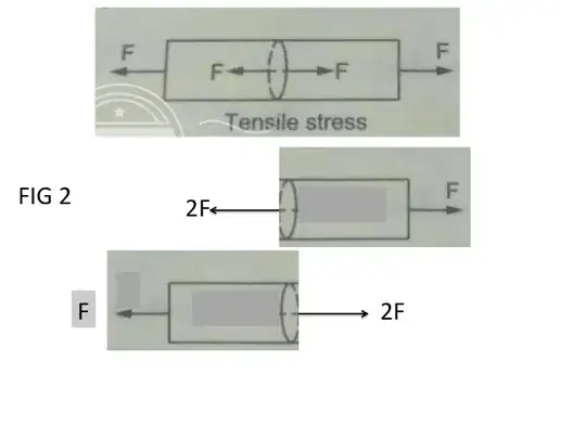

Note that if your replaced the two forces $F$ in the middle of your diagram with $2F$ as shown in my Fig 2 below, there would be a net force on each side of the rope from the cut end.

You can't simply add the magnitudes of the left an right forces divided by the cross sectional area. It is still the equivalent of doubling the forces that actually exist internally.
Let's say that the stress at the cross section actually is $\frac{2F}{A}$. In order to determine the force at the cross section you would multiply the stress times the cross sectional area. That will give you a force of 2F as shown in my Fig 2 free body diagrams, violating the requirements for equilibrium.
Anyone who has taken a course in mechanics of materials learns that the normal stress in a member subject to uniaxial loading (as in your figure) equals the load (force F) divided by the cross section area. Not twice the load.

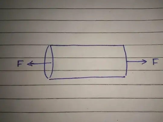

Firstly, by its definition, the restoration force developed per unit area inside the body when subjected to the deforming force is called stress.
Secondly, by Newton's third law of motion every action has an equal and opposite reaction and both act on two different bodies.
Now let's take your rope or whatever body it is in considerationenter image description here

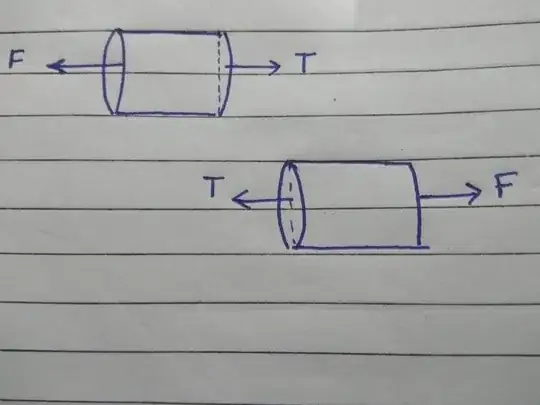

We apply a pair of deforming forces of magnitude F on both ends of the rope, to make sure the body is in rest. Now,
Let's consider a cross-section of the body at a general distance x from left end (sorry, I forgot to show it in the above diagram). There would be some tensile force developed inside the body. If the rope is kept at rest by balanced force F, we can say that T=F.
Now let's consider the equilibrium of any of the parts of the rope.
The tensile force will act as a restoring force (because you know, your rope didn't just snap). Also, applying Newton's third law of motion, we can see that development of tensile restoring force in one of the parts would result in in development of tensile force in its anti-parallel direction, which would be present on the other part. (I hope this line has cleared something for you).
Thus, by applying the definition of stress on any of the part we have,
$\sigma=\frac{T}{A}\\ \Rightarrow\sigma=\frac{F}{A}$
Where ofcourse, A= cross-sectional area of the rope.

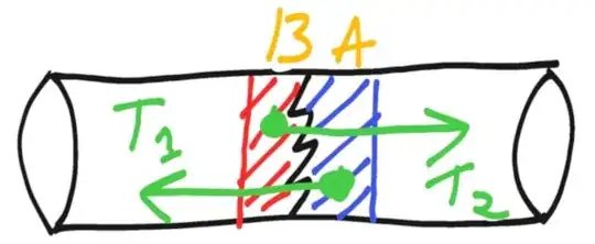

@SteelCubes Has already given a nice answer, i will only repeat similar explanation just with a different picture. Take a look at the process right about the crack begins :
Molecular Van der Waals forces tries to push crack side A to the left, while same forces tries to push side B - to the right. Thus it can be seen that these conflicting forces acts on different bodies (sides) of a crack. Due to that fact you can't sum them. Forces under summation, must act on the same body. That's why we get $$\sigma = \frac FA$$ As an additional argument- stress has pressure units, so must be defined the same way the pressure is defined. Because otherwise it would not be pressure technically.
