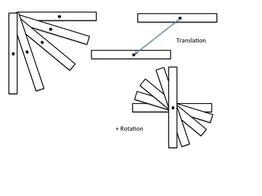

Since the rod's center of mass is changing, does this mean that it also has translational kinetic energy?
Yes.
You have both translational kinetic energy and rotational kinetic energy.
The translational kinetic energy is due to the translational motion of the COM.
Although the rod is rotating about the hinge point, it is also rotating about its COM. It is the latter that constitutes its rotational kinetic energy.
It is easier to visualize this by separating the translational motion from the rotational motion. See the figures below. The figure to the left shows the rod pivoting about the hinge. The top right figure shows the translational motion component of its motion. The bottom right figure shows the rotational component of its motion about the COM.
