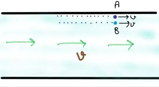

Let us suppose that a fluid is flowing through a pipe (fully filled) of uniform cross section. The fluid is ideal and hence must flow in a streamlined path and must be in a steady state. This means that the path of particles of fluid must never intersect (streamlined flow) and hence the velocity of all particles must be parallel to the walls of the pipe and equal at point (steady flow).
Note: The figure below is a horizontal cross section of the pipe
Since the path is streamlined, the velocity of particles are parallel to each other and to the wall, therefore the particle A will also have velocity parallel to the walls and hence no component of velocity of A is towards the wall.
  1. So how will A exert any pressure on the wall since there is no component of velocity in the direction of wall (it will not strike the wall and hence not exert pressure on it.)
Moreover since the velocities of particle A and particle B are parallel (both particles are in the same horizontal plane), they will not exert pressure on each other? Is it wrong.
What am I getting wrong about streamlined flow?
  1. If the pressure is due to the vibration of a particle which will result in collision with the wall, then my further question is that according to Bernoulli equation, the pressure is different at different velocity but since the the pressure is caused by the vibration of fluid particle and not due to its velocity perpendicular component (which is a contradiction to my reasoning above that perpendicular component of velocity will be zero) then why will the pressure change at all when it is flowing with different velocity (due to increase/decrease in cross sectional area)?

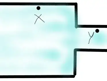

Because if the inter-molecular repulsion at X is some quantity, then the inter-molecular repulsion at Y must be less that quantity(as pressure is less due to Bernoulli Principle at Y), which seems contradictory to me.

When we talk about the velocity of fluid particles (or parcels), we are not referring to individual molecules. The individual molecules have velocities in all directions, and thus exert pressure on the wall. For fluid particles, we are talking about the organized velocity of the molecules, or more precisely their vectorial average which, in flow, has a bias in the direction of flow. The velocities of the molecules are the random motion superimposed on this mean.

About the second question, it is better to think in a greater pressure in the pipe with large diameter. Suppose we are in the frame with the same velocity of the fluid in the larger pipe. For us, the pipe is moving, and the region of diameter reduction is coming to us. The effect is similar of a piston that compresses a fluid, increasing the pressure.

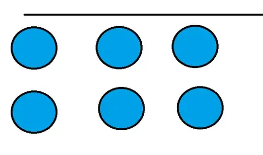

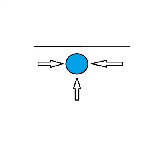

Pressure on the wall is due to two reasons :
  1. Almost contact forces
  2. Hits from each molecule
Now if we assume the flow to be perfectly streamline, the hits are almost zero and thus the walls experience pressure due to almost contact forces (shown diagrammatically in Just Johan's answer)
So, even in a streamlined flow , pressure is not zero on the walls.

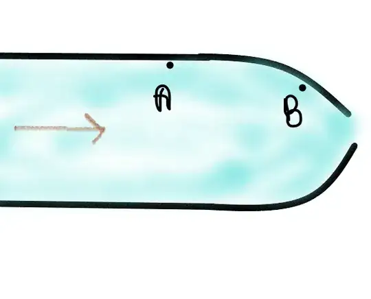

You asked about pressure at A and B on the basis of Bernoulli's Principle in chat, so users who are interested in this may see this chat.
Note : I linked the discussion (in chat) and gave a short answer because I can't paste all those discussions in my answer. The image is also taken from the chat between me and @Satwik.
