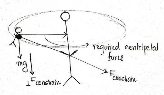

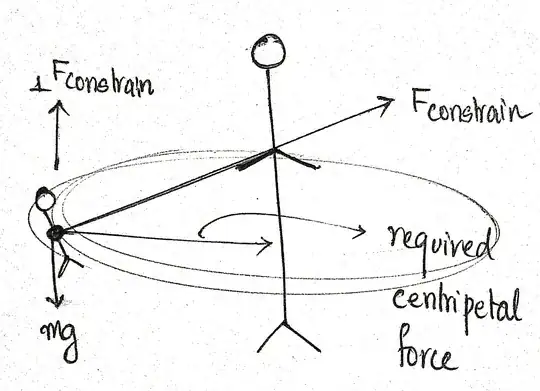

I think I get it
Just for a clearer understanding, I would like to mention the prerequisites early.
  1. when you're pulling with your hands stretched (elbow not bent), its not the hand muscles that are applying the force. Imagine lifting a bucket of water from the ground. Muscles in our hand need not contract for lifting. Its actually the leg muscles that help in lifting. Our arm's inability to stretch (length of bones are fixed) is how we lift it.
  2. So such a force exerted not by our hand but by the constrain that our hand cannot stretch is represented as $F_{constrain}$. When $F_{constrain} $ is insufficient to lift something, we can always put some extra force using our hand muscles. Let this force exerted actually by our hand muscles be $F$.
Answer
It depends on at what height we spin him/her/it. If we spin it below our shoulder level, it seems less heavy. But if we are spinning above our shoulder level, weight seems to be more.
please refer the highly exaggerated stick man diagrams :
In both $fig 1$ and $fig 2$, the spinning object in hand will have a tendency to move away from us. This is prevented by the Constrain that our hand cannot stretch. The crucial point is that this force $F_{constrain}$is not provided by our hand muscles$^*$.
fig(1)
Now, when the rotating body is below our shoulder level, (as In $fig 1$) , this $F_{constrain}$ has an upward component $_{\perp} F_{constrain} $ that acts upward on the object and reduce the weight. Out hand muscles need to provide only the remaining force required. Hence $F$ is small.
If above the shoulder level, $_{\perp} F_{constrain}$ acts downwards and our hand muscles need to support not only the weight of the object but also the downward component of this constrain force, making it heavier.
$*$ : (It should be many muscles near our abdomen, Thighs...)

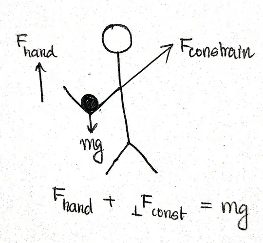

Note : It works not only if our hands are completely streched but also If the object is at any joint like this. enter image description here Since our upper arm cannot shrink or stretch, we will get a similar non muscular force here as well.
