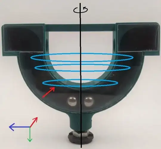

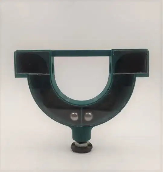

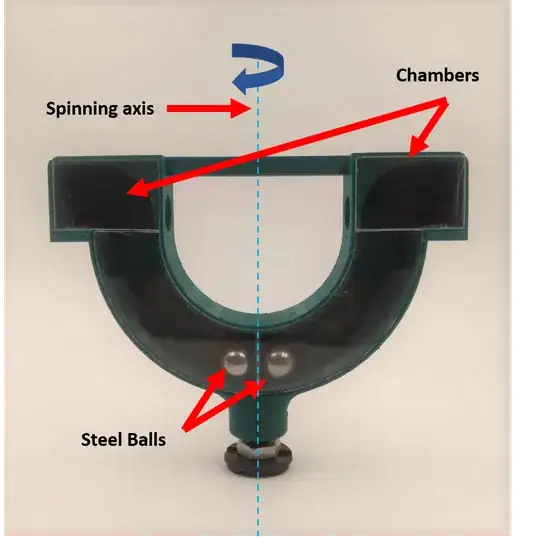

I made a classical experiment to demonstrate centrifugal force. The experimental setup is made to stand vertically and spun along the vertical axis. The balls that initially rest at the bottom, on spinning, move up to the chamber. Can someone please explain in layman terms as to why this happens? I have added images. Free body diagrams can be of great help.

When spun around the balls are set in motion. That motion would continue in a straight line if it wasn't for the wall. The wall causes the motion (the velocity) of each ball to turn all the time. (This is where the centrifugal effect comes from - the balls "feel" swung outwards because they want to continue in a straight line but the wall is in the way.)
It does so with a normal force. But since the wall is tilted at the lower part that normal force is tilted as well (it is always perpendicular to the wall). Meaning that the normal force has not just a horizontal component which causes the turning as described above, but also a vertical component.
It is this vertical component that causes the ball to rise up.

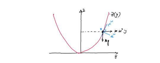

At every instant in the ground frame, the ball spins around an instantaneous circle which I colored light blue in the attached picture, It is due to this rotation a centrifugal force acts in the first place.
(Dark blue vector: centrifugal force, Red vector: normal force, Green vector: gravity)
A normal force also acts it will not be in the same direction as the centrifugal force. This force will help push it up and also cancel a little bit of the centrifugal force, As you can see in the little diagram in the bottom left corner.
It is the resultant of the vertical component of the normal force and gravity that contribute to the rise of the ball and it is the resultant of the centrifugal force and the horizontal component of the normal force which contribute to the radially outward swing of the ball.

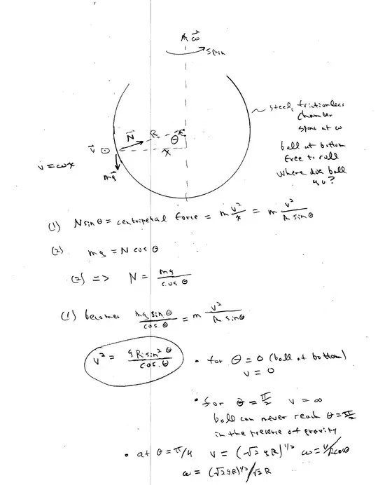

The ball rises so that the constraining force of the chamber on the ball can provide a centripetal force to keep the ball rotating with the chamber. (There is no centrifugal force in the inertial frame.) For a frictionless, circular chamber you can calculate the position up the chamber that the ball rises using a simple force balance in the inertial frame. Solution follows for the steady state. Note that the faster the rotation of the chamber the farther up the ball rises. (You can also do the evaluation in the rotating non-inertial frame considering the centrifugal force present in that frame.) enter image description here
