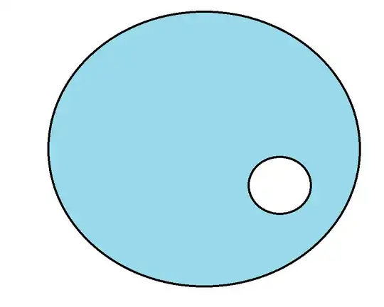

We have a Sphere with radius $R$ and Charge density $\rho$. The center of the sphere is located in the origin. Now inside of that sphere, there's a smaller sphere, with 0 density (no charge), whos center is located in distance $\vec{d}$ from the origin.
For simplicity you may imaging that $\vec{d}=y\hat{y}$ or something along these lines.
The question is now what's the electric field (outside of the spheres, inside the big sphere, and inside the small sphere)?
This question can be solved using gauss law, but I'm unsure if inside of the small sphere you have $E=0$ or something else, because if you choose any close surface $S$, you get that there is no charge inside of that envelope.
If it isn't 0, should we treat the big sphere as one with density of $\rho$ and the smaller sphere with $ - \rho$? If so, then why?
This problem doesn't have spherical symmetry, so there's no way to use Gauss's Law directly. (If I understand what you wrote correctly, you appear to be implicitly assuming that 0 charge enclosed in a region implies that $E = 0$ on its boundary, but this is only the case if there is sufficient symmetry; in general, all Gauss's law says is that the flux through the boundary of some region is equal to the charge enclosed.)
Like you say though, you can treat the problem as the superposition of a sphere of uniform density $\rho$ and a smaller sphere of uniform density $-\rho$, then use Gauss's Law on each of these systems separately, since they do have spherical symmetry (albeit with different origins).
Hope this helps. Happy to elaborate further if necessary.
