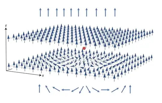

A nice figure illustrates such an instanton event is found in ref.3, where the initial configuration has non-zero skyrmion number, and the final configuration after the instanton event has zero skyrmion number. an instanton event change the configuration of nonzero skyrmion number to zero skyrmion number configuration, take from ref.3

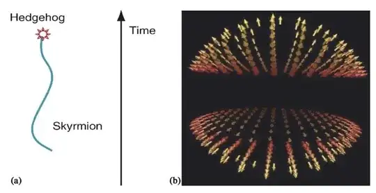

Also, close to this instanton event, a hedgehog figure is usually presented in papers (such as ref.2), where all the neel vectors are putting outward. hedgehog

  1. Does the instanton event change all the neel vectors? For example, as the first figure, the instanton makes all the neel vector point to up direction. Does the instanton just make a part of neel vector flip their arrow (just the part point to down direction) ? Then maybe I want to know the size of the effect.
  2. Does the hedgehog (the second figure posted here)represents all the neel vector of a configuration? (It seems that every slice close to the instanton in a fixed time has skyrmion number 0).
