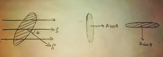

The area does not change. I am assuming that you are not familiar with the concept of flux. Basically the number of magnetic field lines(in your case) passing through the given area changes when the orientation is changed (second diagram)
I really want to understand the math behind it because if it is treated as a vector won't the area have two component?
Since area is a vector, it can be resolved into two directions. While finding flux, we take the components of the area vector which are directed parallel to the electric/magnetic field lines. $|\overrightarrow{A}cos\theta|$ gives the effective area in the direction of the field lines.
EDIT: I forgot to add vector signs in the picture.

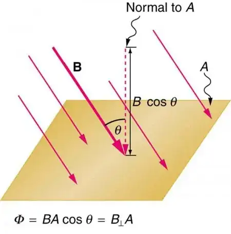

Now when you go for calculation of flux you define it as a number of field lines crossing an area perpendicularly. Now for slanted field lines, we take the area perpendicular to the field lines and we find that we have to take a factor of $\cos\theta$ Now magnetic field intensity is directly proportional to the number of lines crossing the surface. So $$ \Phi=BAcos\theta$$ enter image description here
In vectors, we have developed some tools that are useful so to use that tool of Dot product we define a direction to the Area. $$\mathrm{Dot \ product}=\overrightarrow{A}.\overrightarrow{B}$$
So we take $$\Phi=\overrightarrow{B}.\overrightarrow{A}$$ where B is magnetic field intensity and A is area vector. We have defined this area vector a direction perpendicular to the surface.. See image so that angle between these two vectors becomes $\theta$.
