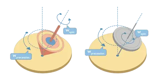

So I am having some difficulty understanding gyroscopic precession. I understand that mathematically by convention torque is perpendicular to the force and so is angular momentum but surely that force is a true force acting outwards as this is what occurs in gyroscopic precession. My question is is this torque a conventional virtual force perpendicular to rotation?
BioPhysicist
  • 59,060
This is a good question. Gyroscopic precession is also what has baffled me the most of all classical mechanics I've encountered.
The force comes from the inertia of the spinning mass. Gravity tries to make the gyroscope (the top) tilt and fall straight down. But while falling down it also spins. The particles at the lower part of the periphery thus experience falling sideways. As they all have this tendency, they collectively turn and the gyroscope as a whole starts turning in a horizontal plane.
In the next moment this exact same thing happens. And just like with circular motion, the turning takes place as infinitesimal changes while the system simultaneously adjust, so that there is no magnitude change but only a direction change. In that same way the gyroscope doesn't fall down (no angular displacement change) but only turns.
enter image description here Source
So no, no involved torques are virtual here. All are real forces and torques. But they appear in an unintuitive manner, just like how unintuitive classical circular motion is where a centripetal force pulls inwards but still the object never comes nearer the centre.
