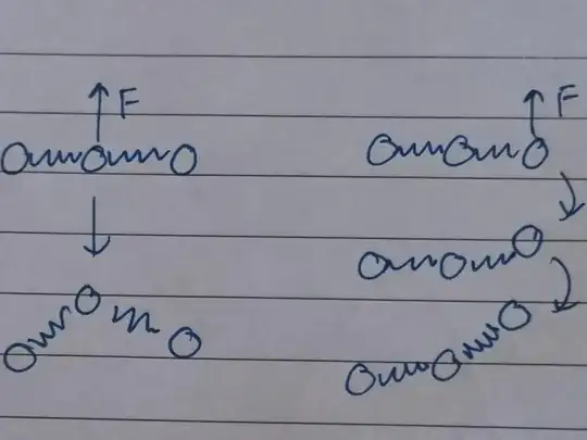

Here's an intuitive explanation for your other query. Consider the setup in the picture (a rod), which can be approximated crudely as 3 balls joined by two springs. If I were to give the centre ball a flick, then it will start moving forward and drag the other two balls along, but because of the symmetry there is no rotation. On the other hand, if I weas to flick the ball on the right, then it will start dragging the balls on the left along with it, but it drags the one closer to it more than the one further from it, so the whole thing starts to rotate. enter image description here Another thing to note is that to create pure translational motion, the force need not be applied at the com, instead the condition is that the line of action of the force coincides with the com. In that case the force produces no torque wr to the com and the result is pure translational motion.

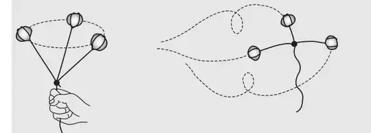

I would start by giving an example that can be found in elementary books (Introduction to Mechanics Klepner & Kolenkow ).
Consider a Bola which consists of three balls of stone or iron connected by thongs. The gaucho whirls the bola in the air and hurls it at the animal. What can we say about its motion?
Since the constraining forces depend on the instantaneous positions of all three balls, it is a real problem even to write the equation of motion of one ball. However, the total momentum obeys the simple equation :
$$\frac{d\mathbf{P}}{dt}=\mathbf{F}_{ext}=\mathbf{f}_1^{ext}+\mathbf{f}_2^{ext}+\mathbf{f}_3^{ext}$$ $$=m_1\mathbf{g}+m_2\mathbf{g}+m_3\mathbf{g}$$
or $$\frac{d\mathbf{P}}{dt}=M\mathbf{g}$$
This equation represents an important first step in finding the detailed motion. The equation is identical to that of a single particle of mass $M$ with momentum $\mathbf{P}$. This is instinctively clear to the gaucho when he hurls the bola; although it is a complicated system, he need only aim it like a single mass.
Now If we are concern with the exact position and rotational motion of each ball, treating the problem as a single mass may not be the best idea. But if we are just concern about the overall motion of the bola then the concept of single might be a good idea. This single example can not tell you the importance of the center of mass but It gives the overall idea.
