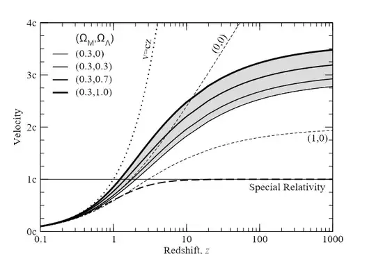

Suppose that 2 observers are sending light signals to each other.If each of them are stationary in relation to a nearby galaxy, but each of these are separated by so great distance, they will be moving apart at speed which is higher than light: enter image description here
How's the type of violation of causality seen in the Krasnikov tube avoided?

The greater-than-$c$ velocities that show up in cosmology have little practical meaning. As one example, in the graph in the question there is a curve labeled "$(0,0)$" which increases without bound, and another one labeled "Special Relativity" which tops out at $c$. Those curves actually describe the same cosmological model: the special case of FLRW cosmology in which the matter density is zero and so the spacetime is just Minkowski space. The reason the curves are different is that they're using two different definitions of velocity. The "Special Relativity" velocity is $dx/dt$ where $x$ and $t$ are Minkowski inertial coordinates, while the "$(0,0)$" velocity is $d(aχ)/dτ$ where $χ$ and $τ$ are FLRW coordinates and $a$ is the scale factor. These are simply not the same quantity, even though they both, in this case, describe the motion of the same object.
