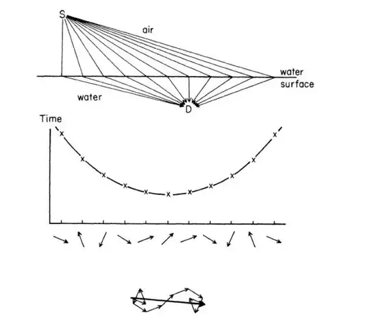

Refraction: Consider an experimental setup where you have a light source in an air medium and a photon detector in the water medium. We want to calculate the the probability that a photon will get from the light source to the detector.
For each path, you have a vector (arrow) that rotating around and around and we need to stop the arrow as times up ( time is taken by light to get the detector). We do the same for each path.
Source: QED The strange theory of light
The graph will be a curve starts up high, goes down, and then back up again; the most important contributions come from the places where the arrows point in nearly the same direction (where the time is nearly the same from one path to the next), which is at the bottom of the curve. That is also where the time is the least, so all we have to do is find out where the time is least.
Which is the so-called Fermat principle The rest of it follows from the Fermat principle. See here.
