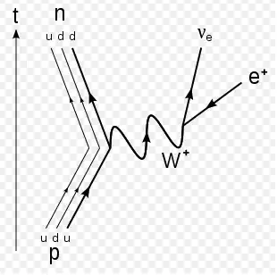

Electrons and electron capture belong to particle physics analysis, i.e. one should look at the feynman diagrams for electron capture.
To start with, there is charge conservation at each vertex.Quarks are charged and take the balance: for a proton to turn into a neutron an up quark absorbs a charge of -1 and becomes a down quark. (The particles indicated in the arrows towards a vertex can be read as antiparticles going away from the pointed vertex).
So as far as charge conservation goes the absorption of a virtual $W^-$ is what changes the up quark to a down quark. The charge of the incoming electron is transferred by the $W^-$ .

At the particle level there are no electric fields carrying energy. The energy is carried by the particles participating and conservation of energy is a law. The charge carried by particles and there is conservation of charge.
So what happens does this change propagate at the speed of light i.e. say somewhere 1 light year away the change will be felt after 1 year?
At the particle level, as there are no photons in the interaction there is no electromagnetic energy going away from the interaction. There are the neutrinos that carry energy away, and in principle if one had an experiment with accumulated data of electron capture and one had very good neutrino detectors, yes they would be seen in the cosmos. Because of the weak interaction being so weak, it is a science fiction scenario.
Also what happens to the energy (if any) which was stored in the electric field does it go to the Neutron and Neutrino?
At this level of analysis there are no electric fields . The energy of the interaction is shared between the elementary particles involved, according to the boundary conditions of the nucleus involved also.
