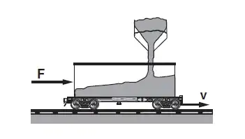

Yeah of course there are many problems you can find in the text on Newtonian mechanics. Here's the one that is familiar to most of us.
Sand falls from a stationary hopper onto a freight car that moves with uniform velocity $v$. The sand falls at a rate of $dm/dt$. What force is needed to keep the freight car moving at the speed of $v$?
Using the force equation for variable mass, we have $$F=\frac{dp}{dt}=m\frac{dv}{dt}+v\frac{dm}{dt}$$ As car is moving with uniform velocity so that time derivative of velocity is zero. $$F=v\frac{dm}{dt}$$ this is the force required to move the freight car at constant speed $v$.
