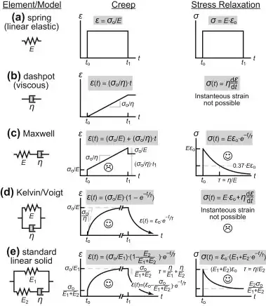

It is probably beneficial to list different other types of material.
This figure summarizes, the most common behaviour of the materials and their models, with wrt time (not deformation).
As other have mentioned, the idea of the purely elastic model is that at any instant its behaviour is dependent on the deformation. Most materials in the majority of structural engineering applications are considered elastic (or at least they were before the progress in FEM codes).
In reality, no material behaves as purely elastic, however, it is a very, very good approximation for a great number of calculations.

Here's one way in which the two definitions are not related: falling within OP's "physical definition" is not a sufficient condition for falling within OP's "mathematical definition". For example, the Kelvin/Voigt model, as illustrated in the answer by @NMech , falls within OP's "physical definition" but not within OP's "mathematical definition". I think the real answer is that different people mean subtly different things by the word "elastic", and the reader must take care.
