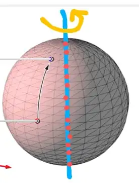

Being a high school student, I read the concept of center of mass and it was written in my book that
When a spinning ball is projected with some velocity , then all the points on the ball have complicated paths except the center of that ball which follows the well known parabolic trajectory. And hence we define that point as center of mass.
However, I think that all the points on the any axis about which the ball is spinning follow the parabolic trajectory and are not influenced by spin .
Edit : Most of the answers argued that the rotation axis may change because of torque but the main point to note here is that we can't differentiate between two axis in case of a sphere since it is symmetric from all sides and also that a sphere can't rotate about more than one axis at a time . So saying that it will rotate about different axis is I think meaningless.
So is it okay to define axis of mass in place of center of mass for sphere or other symmetric bodies or am I wrong somewhere ? If not, give a proper reason.

Your intuition is correct. All the points along the axis of rotation share the same motion. In fact, defining the center of mass by means of the rotation axis isn't sufficient.
It is possible to define the center of mass as the only point where all possible rotation axis pass through for a freely rotating rigid body. So you have to consider all possible lines passing through the center of mass (called a pencil of lines) to define the center of mass.

Even for rigid bodies, the "axis of mass" wouldn't be a fixed line. The axis of rotation could keep changing depending on how the external torques add up vectorially. So the "axis of rotation" wouldn't be a property of the rigid body, but rather something which arises in a particular situation. The axis of mass could literally be any line passing through the center of mass.
EDIT- Responding to your edit, I think the whole point of your post was that, since any point on the axis of rotation can be seen as following a simple path throughout the motion of the ball, so all the axis points are as special as the CoM.
However, this is not true. The other points on the axis are NOT following a simple path in general. In the most general case of a direction changing torque (and hence a continuously changing axis of rotation), any other point (other than the CoM) on any of the instantaneous axes of rotation, is not following a simple path throughout the motion of the sphere. More importantly, the equation $a_{point}=\frac{1}{M}\vec{F_{ext}}$ is only valid when the point is the CoM. This equation is what's responsible for the CoM to follow a simple path. The motion of any other point is affected by the internal as well as the external forces in general.
As for "why don't we define a general diameter of the sphere as the set of all possible axes of rotations?", that'd be useless as any line passing through the CoM of a rigid body can behave as an axis of rotation. The axis of rotation at an instant is entirely dependent on the direction of the instantaneous angular momentum, which is again dependent on the external torques. The CoM, on the other hand, is a fixed property of the rigid body. This is why you study things like: CoM of a circular disc, CoM of a uniform cylinder, etc, instead of the axis of rotation of a circular disc.
I think you might see some sentences in your physics book like "The axis of rotation is always some line passing through the center of mass (unless there's a rotation about a forced axis)". That is all there is to the idea of "axis of mass".

You are right in the case of a sphere. A tennis ball with top spin will not change to side spin during its trajectory for example.
But for less symmetric bodies things are different. If the player throws its racket instead of the ball, the rotation axis will (in general) change indeed. Only the CM follows the parabolic path.

For example, imagine the ball having a torque applied in a direction such that it is rotated around the $y$ axis, suddenly the axis you've shown in the question(assuming it is the z) won't work so well.

If the ball has a single axis of rotation, then all points on that axis will not rotate (that's pretty much the definition of "axis of rotation"). However, it's possible for a ball to have more than one axis of rotation simultaneously, so while their claim is misleading in that it implies that all non-center points always have complicated paths, it is true in the sense that only the center of mass is guaranteed to have a simple path.
As for your question of whether we can define an "axis of mass", that is clearly impossible in the case of a sphere; since the spherical is ... well, spherically symmetric, there's no way to distinguish a particular axis. There is one axis distinguished by the rotation, but that axis is particular to that motion, and not an inherent property of the sphere. Even if there is a particular axis that it is rotating around, there are an infinite number of axes that it could be rotating around.
For objects in general, it is possible to distinguish three principal axes.
Take a globe. Spin it around its normal axis, the polar axis the way the Earth spins. Then pick the globe up and while it is still spinning the first way, flip it north to south the way you would a coin. There you have a sphere spinning over two axes at the same time and your axis of mass makes no sense. The center of mass and only the center of mass is traveling in the parabolic trajectory under your conditions.
