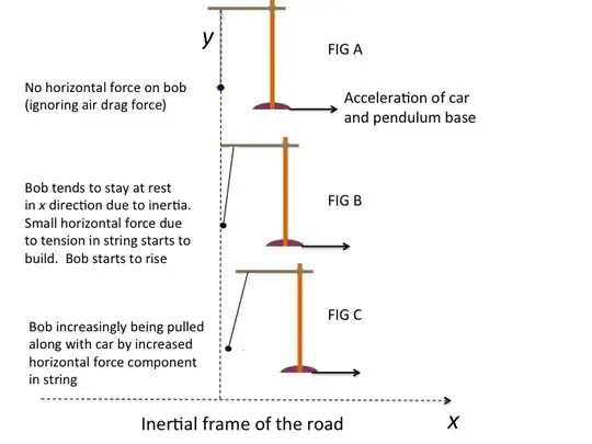

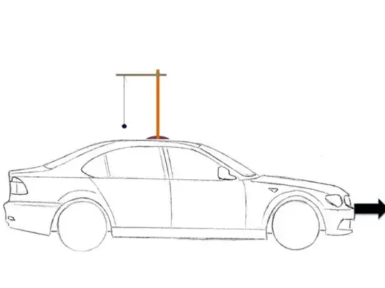

The diagrams below may help to visualize what's happening. The first digram shows the pendulum attached to the roof of the car from the perspective of an observer in the inertial frame (the road). We will assume no air drag force will arise. So initially there are no external horizontal forces acting on the bob.
Figures A-C of the second diagram show the progression of motion of the car/pendulum as seen by an observer on the road (the non accelerating frame). The acceleration begins at Fig A.
In Fig B the car/pendulum base has moved in the x-direction. The bob tends to stay in place horizontally due to its inertia with only a slight displacement (less than the car/base) in the x-direction due to a small horizontal component of the tension in the string.
In Fig C the bob is increasingly being pulled by the string in the x-direction due to the force in the string. Eventually the pendulum angle will reach a maximum value, depending on the car's acceleration, and the horizontal velocity of the bob will be the same as the car.
Hope this helps.
