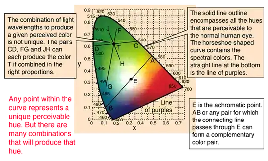

Wavelengths are one to one only with the spectral colors, and wavelengths do not add up to a new one, they remain distinct .
It is the perception of color which is a biological function, due to the receptors of the eye, which creates new hews and colors when more than one wavelength falls on the retina of the eye.
colorpercep
The perceived color will depend on the combination of wavelengths according to the plot above.
