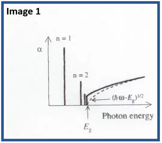

Image 1 represents the absorption spectra of a semiconductor at low Temperature (excitons can form)

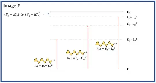

Image 2 is a schematic representation that I have drawn based on my understanding

  • In reference to Image 1, I take the n = 1 absorption line. Such an exciton will have binding energy equal to Eex1. When I supply the material with a photon of energy equal to ħω = Eg – Eex1 , the material will absorb this photon and this energy will go into creating an exciton that has a quantum number n = 1.
  • As we increase the energy that we supply to the material in the form of photonic energy we can force the material to form excitons with n = 2 (using photon energy of ħω = Eg – Eex2 ), n = 3 (using photon energy of ħω = Eg – Eex3 ) and so on (Image 2).
  • Overall, when you supply specific photonic energies less than the bandgap, you get characteristic absorption in the material at specific energies corresponding to exciton formation. When you supply energy equal to or greater than the bandgap energy you get interband absorption, with electron transfer occurring directly from the valence band to the conduction band, no excitons form at these energies.
I drew Image 2 based on my understanding so it may not be the correct representation.

An exciton can form when a material absorbs a photon of lower energy than its bandgap. This can be seen in image 1 where we get characteristic lines such as n = 1 describing the formation of excitons.
I've discussed the nature of exciton a few days ago in response to your other question. So, applying what is said there to what you ask now: Excitons can form when semiconductors are illuminated at sub-gap energies - as the spectra that you have shown demonstrate. They can also form when the photon energy is above the band gap, in which case the electron and the hole have to lose some energy to get to the bound excitonic state (to phonons, via electron-electron collisions, etc.)
So yes, the statement that you are referring to is unprecise. Unfortunately, this rather simple nature of excitons is systematically misrepresented.
