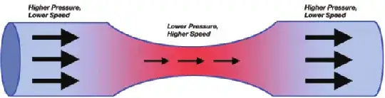

When velocity increases then you obviously have acceleration. Now what is causing this acceleration? As always (according to Newton's second law, $\vec{F}=m\vec{a}$) acceleration is caused by a force. In this case the force acting on a piece of fluid comes from the pressure difference, making a net force pointing from higher pressure to lower pressure.
(image from ResearchGate - Diagram of the Bernoulli principle)

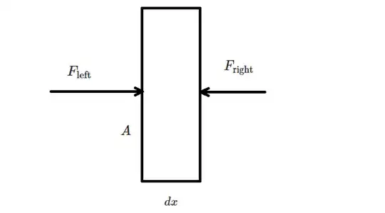

Consider a small cylindrical slab of fluid (with mass $dm$, area $A$, thickness $dx$, and moving with velocity $v$).
From Newton's second law we have $$dm\frac{dv}{dt}=F_{\text{left}}+F_{\text{right}} \tag{1}$$
The mass of the slab of fluid is $$dm=\rho A\ dx \tag{2}$$
The pressure forces acting on the left face (where pressure is $p$) and on the right face (where pressure is $p+dp$) are $$\begin{align} F_{\text{left}} &=pA \\ F_{\text{right}}&=-(p+dp)A=-\left(p+\frac{\partial p}{\partial x}dx\right)A. \end{align} \tag{3}$$
Inserting (2) and (3) into (1) we get $$\begin{align} \rho A\ dx\frac{dv}{dt} &=pA-\left(p+\frac{\partial p}{\partial x} dx\right)A \\ &=-\frac{\partial p}{\partial x}dx\ A. \end{align} \tag{4}$$
Dividing by $A\ dt$ we get $$\rho v\frac{dv}{dt}=-\frac{\partial p}{\partial x}\frac{dx}{dt} \tag{5}$$ or $$\rho v\frac{dv}{dt}+\frac{\partial p}{\partial x}\frac{dx}{dt}=0. \tag{6}$$
This can be rewritten to give $$\frac{d}{dt}\left(\frac{1}{2}\rho v^2+p\right)=0 \tag{7}$$ or $$\frac{1}{2}\rho v^2+p=\text{const} \tag{8}$$ which is just Bernoulli's law.

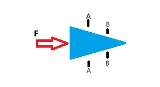

If force F pushes a conical object to obtain acceleration to the right, then the pressure at different sections of this conical object must be different. For example, the pressure on the AA section will be higher than that on the BB section.
The same applies to the water in the converging nozzle. The water on the right has a higher velocity than the water on the left, but the water on the left has a higher pressure than the water on the right. It's that simple.
