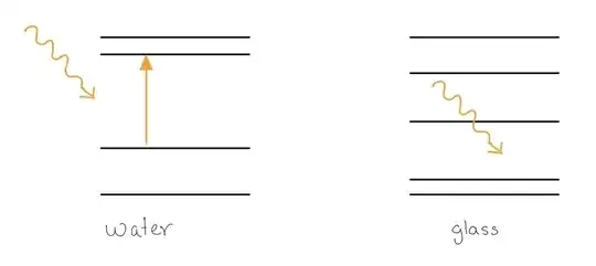

Like Bob has mentioned, the container doesn’t absorb the microwave. The reason for this lies in quantum mechanics according to which the energy levels of atoms are quantised. This means the atom can’t have any arbitrary energy and can only absorb energy corresponding to the difference of the allowed energy levels (see figure below).
Microwave ovens radiate light having discrete energy chunks of $10^{-5}$ eV. This frequency is particularly chosen because water has energy level separation such that it strongly absorbs this light. And since most food we consume contains water, this is an efficient way of heating them provided that the container doesn’t absorb/reflect any of it. Glass and ceramics don’t have energy level separation corresponding to this frequency so they don’t absorb any.
So the only process by which it is getting heated up is by conduction through the water it is containing.
