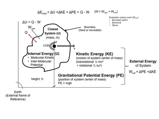

I like to call the kinetic energy and potential energy of the center of mass the objects external energy, that is, e.g. its kinetic and gravitational potential energy with respect to an external frame of reference, such as the ground. The microscopic kinetic energy of the particles of the object with respect to the COM is the internal microscopic kinetic energy of the object. The intermolecular forces between particles are the microscopic potential energy part of the internal energy. These concepts are illustrated in the diagram below.
