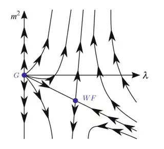

I'm not certain what exactly you're looking for with your first bullet, but I'll address the second bullet by looking a an exactly-solvable model with a nontrivial RG flow which can be determined just by looking directly at correlation functions rather than deriving beta functions. It's the large-$N$ limit of $\phi^4$ theory: $$ \mathcal{S} = \int d^dx \,\left[ \frac{1}{2} \left( \partial_{\mu} \phi_{\alpha} \right)^2 + \frac{\lambda}{2N} \left( \phi^2_{\alpha} - N m^2 \right)^2 \right]. $$ Here I'm using slightly different notation to facilitate a large-$N$ expansion, but by multiplying out the last term you get the usual $\phi^4$ theory with some factors of $N$ and $m^2$ placed differently than you're used to (and an unimportant constant). For $2 < d < 4$, the RG flow of this theory is known to look like the following (picture credit https://arxiv.org/abs/1811.03182):
The flows to $m^2 = \pm \infty$ describe a flow to a gapped theory where all correlation functions decay exponentially at long distances, so they're not quite as interesting as the line connecting the free massless theory $G$ to the massless Wilson-Fisher fixed point $WF$. We will see that although all correlation functions will be algebraic at both large- and small- distances, there is a crossover of critical exponents between the two asymptotic cases. The constant $\lambda$, which has units of $\mathrm{(energy)}^{4-d}$, will play an essential role here.
