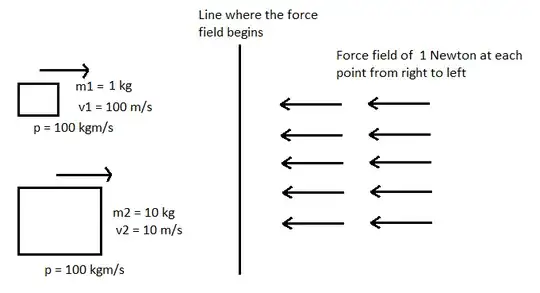

Let me try to answer this with the help of a simple example and just the equations of motion.
example
In the diagram above we have got two objects with mass and velocity annotated as shown, the direction of motion of these objects is from left to right and we can figure out that momentum $\left( p \right)$ of both these objects are the same, now to the right of the diagram from the line drawn there is a force field that exerts $1$ Newton of force at each point from right to left. Now with the information we have, let's try to find out the distance they travel in the force field till they come to stop as the force acting is opposite to the direction of the objects motion.
For the top object, the negative acceleration $a = \frac{1 N}{1 kg} = 1 \frac{m}{s^{2}}$
With the help of equation $v^{2} = u^{2} + 2 a s$
$0 = \left( 100 \right)^{2} + 2 \cdot \left( -1 \right) \cdot s \implies s = 5000 m$
So the distance to stop for the top object in the force field is $5000$ metres.
Now for the bottom object, the negative acceleration $a = \frac{1 N}{10 kg} = 0.1 \frac{m}{s^{2}} \implies 0 = \left( 10 \right)^{2} + 2 \cdot \left( -0.1 \right) \cdot s \implies s = 500 m$
The distance to stop for the bottom object in the force field is $500$ metres.
Now we clearly see that even though both objects had the same momentum, it took different distances for the force field to stop them, this quantity of how much something is required to bring them to stop is Kinetic Energy or just energy, which momentum alone cannot describe.
