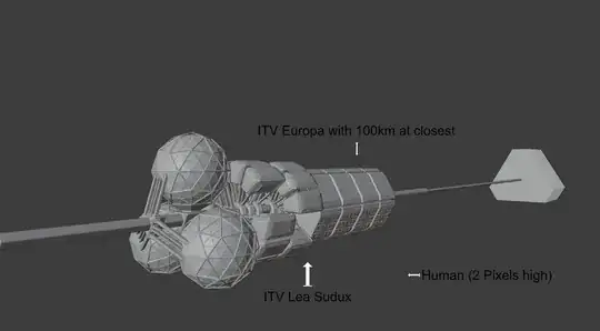

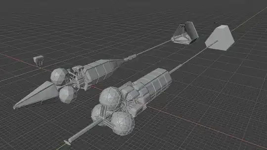

EDIT #1 Here are some WIP Pictures of the Situation. Not renders because, as it turns out, in deep space there really is no sun :D
This shows the 2 Stages of Modelling most things. One very low detail mock up to get the idea across and then the high detail one, which as you can see is still WIP. You can see the Multi Layered Shield of the Craft, the Radiators are still missing though.
This one shows what everything might look like, at least without fancy light. The Europa is around 150km away and once it is at its closest point, it will only be 100km away. The Main shield is already out of view at this point. Also, Human for scale.
