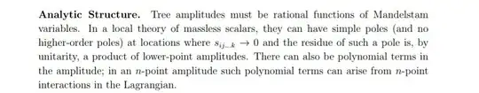

In Bootstrap and Amplitudes: A Hike in the Landscape of Quantum Field Theory there are few statements about analytical structure of amplitudes.
I want to understand statement:
Tree amplitudes must be rational functions of Mandelstam variables.
What is the reason for such a property of tree level amplitudes? What is the simplest explanation of such a fact?
Comments about other analytical properties are also very appreciated!
