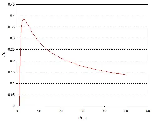

The velocity of an object falling freely from infinity is discussed in my answer to Will an object always fall at an infinite speed in a black hole? and we get the result:
$$ v = \left(1 - \frac{r_s}{r}\right)\sqrt{\frac{r_s}{r}}c \tag{2} $$
and this looks like:
Velocity
The velocity initially rises as the object falls inwards, but then very near the horizon the time dilation dominates and the object slows again and after infinite time comes to a halt at the horizon. We get the time taken to reach a distance $r$ by integrating this expression, but sadly it doesn't have a closed form integral and we'd have to do it numerically.
At this point I have run out of enthusiasm for doing the calculation, but I did calculate the time taken to fall to $1\%$ of the horizon distance in my answer to Can you have a giraffe shaped black hole? and the result was under a millisecond.
