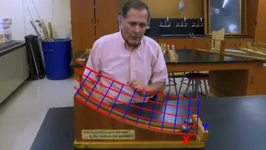

To understand the movement, lets look at the situation in some funny coordinates known as curvilinear coordinates. Instead of making the x and y axes straight, we make it curved, following the track. Lets make the x axis be along the curved track, and the y axis be perpendicular to the curved track.
Curvilinear Coordinates
This is useful because it gets rid of the annoying changing normal force. Since the y axis is perpendicular to the track, we know that the normal force is always in this direction. Because its not in the x direction, along the track, the normal force can't add any velocity. We can ignore it. This is so helpful that it's worth the frustration of dealing with axes that are curved!

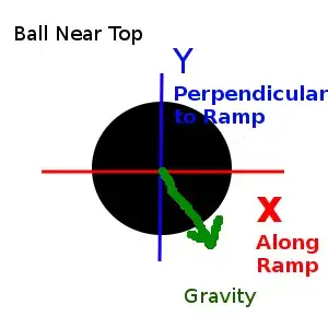

Which leaves us only with gravity. If the ball is very far up the track, where it is at a substantial angle, the force of gravity has a reasonable component in this x direction, along the path of the track. So a ball that starts on the top of the track accelerates forward quickly.
Free Body Diagram

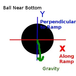

A ball that starts closer to the bottom of the track has gravity pulling almost in the y axis - almost perpendicular to the track. Since it has almost no acceleration in the x direction, along the track, it accelerates much more slowly.
Free body diagram
