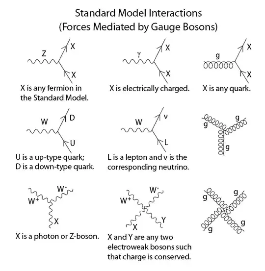

If you are interested in the possible interactions allowed by the Standard Model, this diagram from the Wikipedia article will be of interest. Unfortunately, it doesn’t include interactions involving Higgs bosons.
