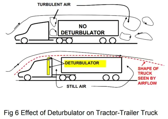

So what about the force needed? Well, it seems to me that there's enough in the force of the vortices caused by the pressure differential between air to either side of the truck and that at the very rear. For example, see this image from a paper about a drag-reduction device:

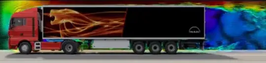

Less clear, but more fun to watch, is this marketing video for a whole-truck fairing meant to reduce drag:

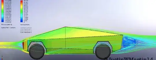

You can also see the vortices in this article about the drag experienced by Tesla's Cybertruck:
More generally: high pressure air from the space around the truck, above and below, but especially the sides, will tend to move to the low pressure area formed behind the truck. But the air has inertia; it can't make the 90-degree turn immediately, so it winds up a bit behind the low pressure area and starts to curl as it is pulled forward back into it. This creates vortices, and these vortices have forward motion relative to the vehicle. That is, the air is actually moving forward faster than the vehicle itself is moving.
All that has to happen is for the box, as it rises back up into the turbulence, to get caught just right in one of these vortices and get pushed forward. Of course, the vortex itself doesn't necessarily blow straight into the back of the truck (though some of the air will, my point is that it's not necessary even for any of it to). The air eventually turns even more, curling around and becoming turbulent. But the air has a lot less mass than the box. It can turn more than the box can; the box, after that initial push, can't make the turn and falls out of the vortex with the extra forward energy it was given, landing it back in the truck.
The bottom line: aerodynamic drag is a significant problem in large, boxy vehicles like this, specifically because of the relatively large pressure differential that exists between all the air that's been pushed out of the way of the vehicle and the space immediately behind the vehicle that the vehicle is leaving (which is essentially a vacuum, if not for all that air rushing back in to fill it). Just as pressure differentials such as these can keep a Boeing 747 or Airbus 380 aloft (for example, to name a couple of larger airplanes), certainly the force created by such a differential could push a lightweight box just a few feet forward to place it back in the truck it just fell out of.
