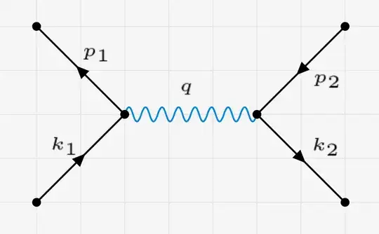

Yes. It is possible to treat linearized gravity like a QFT, write the graviton propagator and study the scattering of two photon thought a graviton exchange. Scattering of two photons The amplitude, given the momentum of the two photons $k_{1}$ and $k_{2}$, in the limit where the graviton propagator momentum $q \rightarrow 0$ behaves proportionally to $$\sim \frac{(k_{1} \cdot p_{1})(k_{2} \cdot p_{2})}{q^{2}}$$
This means that two photons that are moving in the same direction do not interact gravitationally.
Further references can be found in the QFT book by Zee.
