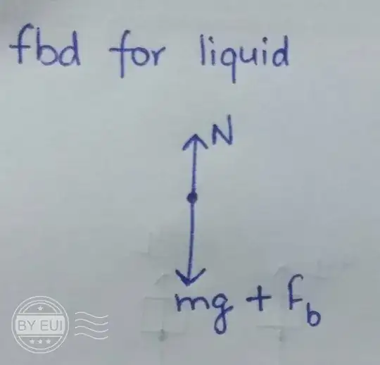

I don't think you will feel less however the plastic (if could sense ) will of course feel less weight .
Let me explain.
Since the liquid applies buoyant force on the plastic (say $F_b$ ) so by Newton's third law the plastic also applies a force $ F_b$ on it in the downward direction . So the forces acting on the liquid are $Mg$ , $F_b$ and the normal force $N$ due to the bottom part of the bucket . Here's the fbd for the situation
Now what you feel is the normal force due to the bucket and this is equal to the normal force ($N$) applied by the liquid on the bucket in downward direction ( since bucket Also applied the same force on the liquid which is shown in the fbd).
So you feel more force .
Note : I have considered forces only in the vertical direction however there are forces on the liquid by the bucket in contact in other direction also.
Hope it helps .
