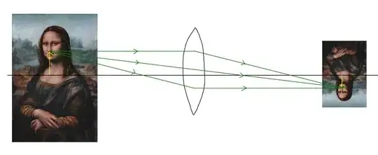

Think about a portrait located positioned on the left side of the lens. The light emanating from a point on the tip of the nose focuses to the (single) corresponding point on the image. The same is true of all the neighboring points, so there is a one-to-one correspondence between points on the image and points on the object, and the image is clear.

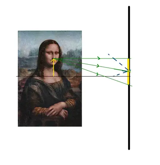

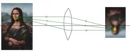

On the other hand, if you position a screen at a different location, then the light emanating from the tip of the portrait's nose will be spread over a whole region of the screen. The light from the neighboring points on the object will overlap, and the result will be a blurred image.

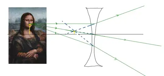

The conclusion is that the calculated image distance is where you will get a clear image; if you put your screen anywhere else, then an image will not form. Now consider what you'd get with a diverging lens.
The blue dotted lines are obtained by tracing the rays on the right hand side backward and pretending the lens wasn't there. The virtual image is the location from which the rays appear to be emanating from the perspective of somebody on the right-hand side of the lens. However, there are no actual light rays which converge there. If you place a screen at the location of the virtual image, can you see why you don't get a nice picture?
