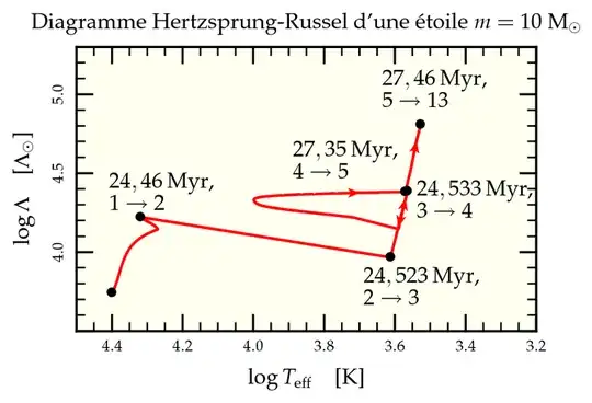

You could look at tools like EZ-web or interpolation formulae like those from Hurley, Pols and Tout 2000 to infer how much time a given star (say O-type) spend in a given state compared to the time spend in the Main Sequence. For example an initialy $10M_\odot$ star would spend around 25 Myrs on the main sequence and only 3 Myrs being a red giant as you can see on the next picture that I made during my PhD (in french, sorry). Stage 1 is the main sequence and stage 3 to 5 are various reg giants stages.
a 10 solar masses star evolution within the HR diagram
(source: rubyforge.org) !
Thus you could infer that if you have found 25 $10M_\odot$ stars on the main sequence in your sample, there should be around 3 of them being red giants in the same sample (this reasoning naturally won't hold if your sample has some precise age like a star cluster for example). Knowing the probability to get a given star on the main sequence and converting it to numbers for, say, a million stars, you could know how much red giants you would expect to find in addition to this million stars.

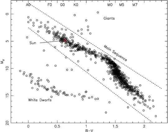

This might help. It is a Hertzsprung Russell diagram created for the closest 1000 stars to the Sun, according to the 3rd catalogue of nearby stars by Gliese and Jahreiss (1991 http://cdsarc.u-strasbg.fr/viz-bin/Cat?V/70A ). I have labelled it with spectral types. EDIT: Now superseded by the Gaia catalogue - see edit at the end.
Although this catalogue is now getting a bit dated and there are now (smaller) catalogues of very nearby stars that are more complete, it still provides a pretty good census of the relative proportions of stars in the disk of our Galaxy near the Sun.
A HR diagram for the 1000 stars closest to the Sun from Gliese and Jahreiss (1991).
The wikipedia results you refer to tally quite well with the main sequence stars that dominate this plot. About 6% of the sample are white dwarfs, though this might be a lower limit because the Gliese and Jahreiss catalogue becomes demonstrably incomplete for an absolute V magnitude greater than 11. Less than 1% of the sample are evolved (sub)giants. There are no red (M-type) giants, so their occurrence rate must be smaller than a few in a thousand. It is difficult to provide a larger census because it is difficult to estimate the distance to stars outside of the solar neighbourhood.

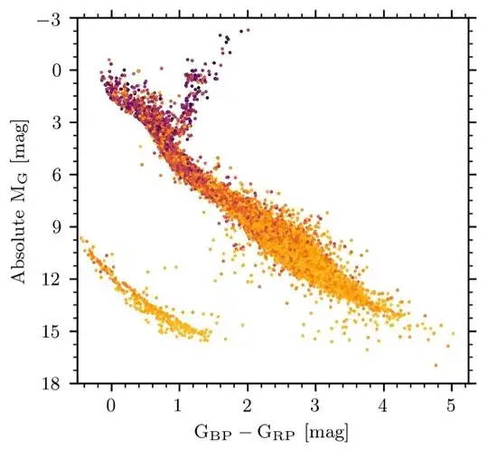

The catalogue discussed above has been almost entirely supersed by the Gaia EDR3 Catalogue of Nearby Stars. This contains a census of about 330,000 stars within 100pc of the Sun. The absolute colour-magnitude diagram of this sample is shown below - which illustrates the various evolutionary phases, main sequence, white dwarfs, red giants. Again, there are no red supergiants within 100 pc of the Sun - they are very rare. To use this catalogue you will need to understand the levels of incompleteness as a function of star type (the catalogue is not complete).
Colour-magnitude diagram for stars within 100pc from Gaia EDR3
