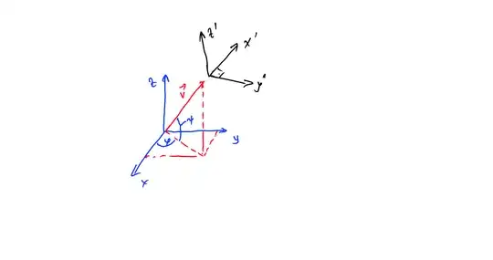

you can obtain the spatial Lorentz transformation by applying two rotations .
we want to "bring" the x axes align to the x' axes, this can done by two rotation , first rotate about the z axes with the angle $\varphi$ and then rotate about the new y axes with the angel $-\psi$. thus:
the transformation matrix about the z-axes is:
$$S_z=\left[ \begin {array}{cccc} 1&0&0&0\\ 0&\cos \left( \varphi \right) &-\sin \left( \varphi \right) &0 \\ 0&\sin \left( \varphi \right) &\cos \left( \varphi \right) &0\\ 0&0&0&1\end {array} \right] $$
and about the new y-axes is:
$$S_y=\left[ \begin {array}{cccc} 1&0&0&0\\ 0&\cos \left( \psi \right) &0&-\sin \left( \psi \right) \\ 0&0&1&0\\ 0&\sin \left( \psi \right) &0&\cos \left( \psi \right) \end {array} \right] $$
with : $$\varphi=\arctan\left(\frac{v_y}{v_x}\right)$$ $$\psi=\arctan\left(\frac{v_x}{\sqrt{v_x^2+v_y^2}}\right)$$ and the boost vector $$\vec{v}=\begin{bmatrix} v_x \\ v_y \\ v_z \\ \end{bmatrix}$$ you obtain the spatial Lorentz transformation :
$$L_D=S_z\,S_y\,L\,S_y^T\,S_z^T$$ with the Lorentz transformation $L$
$$L=\left[ \begin {array}{cccc} \gamma&\gamma\,v&0&0\\ \gamma\,v&\gamma&0&0\\ 0&0&1&0\\ 0 &0&0&1\end {array} \right] $$
$\Rightarrow$
$$L_D=\left[ \begin {array}{cccc} \gamma&\gamma\,v_{{x}}&\gamma\,v_{{y}}& \gamma\,v_{{z}}\\ v_{{x}}{\gamma}^{2}&{\frac {\gamma \,{v_{{x}}}^{2}+{v_{{y}}}^{2}+{v_{{z}}}^{2}}{{v}^{2}}}&{\frac { \left( \gamma-1 \right) v_{{y}}v_{{x}}}{{v}^{2}}}&{\frac {v_{{x}}v_{{ z}} \left( \gamma-1 \right) }{{v}^{2}}}\\ v_{{y}}{ \gamma}^{2}&{\frac { \left( \gamma-1 \right) v_{{y}}v_{{x}}}{{v}^{2}}} &{\frac {{v_{{x}}}^{2}+{v_{{y}}}^{2}\gamma+{v_{{z}}}^{2}}{{v}^{2}}}&{ \frac {v_{{y}}v_{{z}} \left( \gamma-1 \right) }{{v}^{2}}} \\ v_{{z}}{\gamma}^{2}&{\frac {v_{{x}}v_{{z}} \left( \gamma-1 \right) }{{v}^{2}}}&{\frac {v_{{y}}v_{{z}} \left( \gamma-1 \right) }{{v}^{2}}}&{\frac {{v_{{z}}}^{2}\gamma+{v_{{x}}}^{2} +{v_{{y}}}^{2}}{{v}^{2}}}\end {array} \right] =\begin{bmatrix} \gamma & \gamma\,\vec{v} \\ \gamma\,\vec{v} & I_3+\frac{\gamma-1}{v^2}\vec{v}\,\vec{v}^T \\ \end{bmatrix}$$
