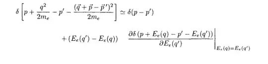

I am computing the Boltzmann equation for Photons from the book "Modern Cosmology" by Scott Dodelson.
This is the colission term from Compton scattering
Then, the Dirac delta is expanded
I am trying to understand how to expand the Dirac delta function and also how to derivative it. I don't know if it's possible. The book is very clear but my problem is whith the calculus of Delta Dirac.

Expanding the Dirac Delta
I'm no expert, but this seems to be very sloppy mathematics, even for a Physics textbook.
Essentially what the author is trying to do there is perform a Taylor Series expansion on the Dirac Delta function. The problem with this is that the Dirac Delta function is not a "function" in the mathematical sense but a generalised function or a distribution. As such, it is not obvious to me that it has a Taylor Expansion.
Nevertheless, it is possible to write the $\delta(x)$ function as the limit of series of continuous functions (my favourite is:
$$\delta(x) = \lim_{a\to0}\delta_a(x) , \quad \quad \text{ where }\quad \delta_a(x) = \frac{1}{\sqrt{2\pi a^2}}e^{-x^2/2a^2},$$
a limit of squished Gaussians), and I assume that you can expand $\delta_a(x)$ however you wish since it's smooth and well behaved for all $a\neq 0$. Perhaps this is the author's justification? I don't know. But the rest is straightforward.

For those who stumble upon this question in the new edition of Dodelson's book, here is a somewhat straightforward approach to the answer.
A Taylor expansion has the following form, to first order:
$$ f(x) \simeq f(x_0) + \frac{\partial f(x_0)}{\partial x}(x-x_0) $$ Then, for a translated function: $$ f(x-a) \simeq f(x_0) + \frac{\partial f(x_0)}{\partial x}((x-a)-x_0) $$ Note: There are no changes to the differentiation because we assume "a" is a constant, so $d(x-a) = dx$
In our case, for $x_0 = p − p′$, we have: $$ \delta_D(p − p′ + E_e(q) − E_e(|q + p − p′|)) \simeq \delta_D(p − p′) + \frac{\partial \delta_D(p − p′)}{\partial p}((p − p′ + E_e(q) − E_e(|q + p − p′|)) - (p − p′)) $$ Using equation 5.14 from the book to simplify, we obtain the second line: $$ \delta_D(p − p′) + \frac{(p' - p)\cdot q}{m_e} \frac{\partial \delta_D(p − p′)}{\partial p} $$
