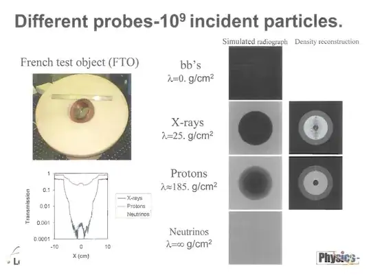

This makes it possible to use protons to image things built with high $Z$ material, materials like lead, tungsten, uranium, and plutonium. Hence, the proton radiography group at Los Alamos National Laboratory (https://lansce.lanl.gov/facilities/pRad/index.php).
The French Test Object is made of various spheres of (non-fissile) high $Z$ material, and is used for testing.

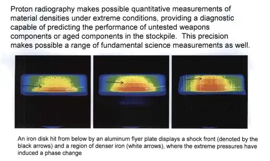

Flash proton radiography also allows the imaging of detonation fronts in various explosive configuration. (All images are from the above link to LANL).

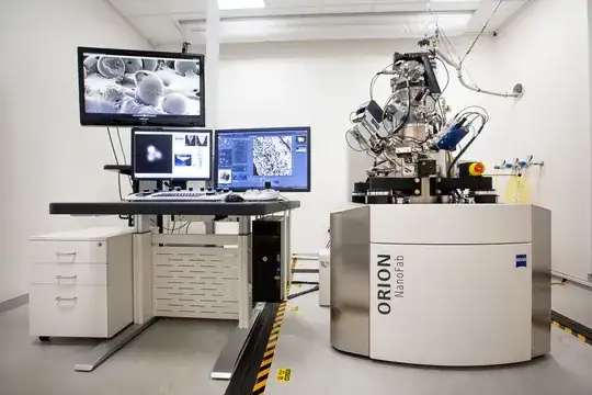

Zeiss sells such a Helium ion microscope, take a look at the instrument below.

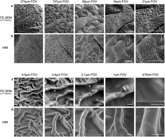

Using a Helium ion microscope, you can take some very nice images of the Arabidopsis thaliana plant taken from this paper as also shown below. enter image description here
