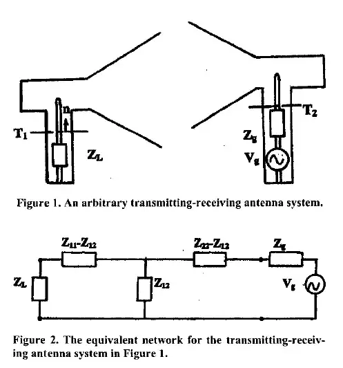

I will try to summarize the classic results from 1, 2, 3. In short, a receiving antenna does not scatter as much power as it absorbs except in a few very special cases such as a very short dipole or a small loop. For these small dipoles, when the incident wave induces the same current distribution as would be seen when the antenna is used and driven as a transmitting one, then the scattered field energy is the same as the absorbed energy when used as a receiver.
In general though the scattered and absorbed fields have no such relationship. To see this note that a receiver antenna cannot just be analyzed as an antenna by itself. In fact, its behavior depends both on its orientation and distance to the transmitter antenna. These can be described by a reciprocal 2-pole network and its corresponding $2\times2$ impedance (admittance) matrix
$$\mathbf Z =\begin{bmatrix} Z_{11} & Z_{12} \\ Z_{21} & Z_{22} \end{bmatrix}$$
that can be represented as a "T" (or a "$\Pi$") network. Assume that the transmitting generator has open-circuit $emf$ $V_g$ with internal impedance $Z_g$ and is connected via a transmission line to the antenna ports $2$, while the load impedance is $Z_L$ and it is attached to port $1$.
The $Z_{12}=Z_{21}$ transfer impedance represents the coupling between the antennas through air and its magnitude is proportional to the squared reciprocal distance between the transmitter and receiver antennas and, in practice, it is many orders smaller than either $|Z_{11}|$ or $|Z_{22}|$. The figures below taken from [3] shows the impedance matrix representation and, hence, the Thevenin equivalent. (While both can be used if instead a $T$ we would use a $\Pi$ network then the admittance matrix representation would be more convenient to get the Norton equivalent.)

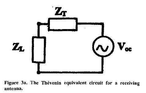

In the Thevenin equivalent we have $$Z_T = Z_{11}-\frac{Z_{12}^2}{Z_{22}+Z_g}\\ V_{oc}=\frac{Z_{12}}{Z_{22}+Z_g} V_g $$
The Norton equivalent short circuit current is $I_{sc}=\frac {V_{oc}}{Z_g}$
The received absorbed and network dissipated powers are $$P_L = \frac{1}{2} \left | \frac{V_{oc}}{Z_L+Z_T} \right |^2 \Re \{Z_L\} \\ P_D ^t = \frac{1}{2} \left \lvert\frac{V_{oc}}{Z_L+Z_T}\right\rvert ^2 \Re \{Z_T\} $$
Interestingly, if we use the Norton equivalent we get the dissipated network power as $$P_D^n = P_D^t \left\lvert \frac{Z_L}{Z_T}\right \rvert^2= \frac{1}{2} \left\lvert\frac{V_{oc}}{Z_L+Z_T}\right\rvert ^2 \Re \{Z_T\} \left \lvert \frac{Z_L}{Z_T} \right\rvert^2$$
This result immediately shows that one cannot and should not interpret $P_D$ as scattered power when we use the Thevenin or Norton equivalents to calculate the dissipated power inside the network because they can be *different*. Instead, one may use these equivalent circuits to calculate the power dissipated in the load *only*.
For example, if the receive antenna is open circuited then there is no absorbed power nor internal dissipation, $P_D=0$, and get the completely nonsense result that the antenna does not even scatter. On the other hand, in the open circuit case the Norton equivalent shows a complete reflection from the antenna. When the load of the receive antenna is matched to the driving point impedance then $Z_L = Z_T^{*}$ and we do have $P_D^n=P_D^t$ and it could interpreted for a small dipole as the scattered power, see Collin for details.
Transmit-receive antenna pair represented as a 2-pole network
Thevenin equivalent

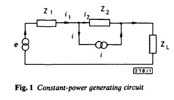

Another approach is that of Love who instead of using a Thevenin (or Norton) equivalent circuit that uses a constant voltage (or current) source synthesizes a constant power source representing the incident power wave directly. This is shown below
constant power source - the "Love" equivalent

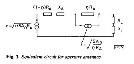

For aperture antennas Love shows that the voltage and current sources of his equivalent circuit depend as in below where $\eta$ is the aperture efficiency. His analysis concentrating on aperture antennas, while not generally valid for arbitrary antennas, removes the apparent contradictions and is in agreement with normal physical (engineering) intuition.
Love equivalent for aperture antennas
