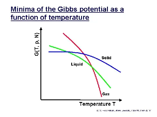

We can also show this effect schematically. Below is a schematic of the chemical potential vs. temperature for solid, liquid, and gas. The slope of each curve is the entropy of that phase (high for gases, low for solids), and the absolute-zero intercept is the enthalpy (slightly higher for liquids than solids because of the poor intermolecular bonding, much higher for gases because of the lack of such bonding). The lowest curve at any given temperature is always the equilibrium phase at that temperature. Note that if the liquid curve is dropped (because the water concentration decreases when you add impurities), the intersection with the pure solid curve moves to a lower temperature, and the intersection with the pure gas curve moves to a higher temperature. This is illustrating the same phenomenon of boiling point elevation and freezing point depression.
