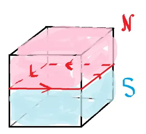

Well, concerning the question, it should follow from the discrete version of the Stokes' theorem. Consider a cube, in case of a nonzero flux, piercing the cube, one cannot assign globally the gauge potential $A_\mu$, only locally, in a certain chart. Let us divide the cube into two charts, overlapping at least on the equator enter image description here
The northern and southern hemisphere. According to the Stokes' theorem flux through the pale red surface is equal to the circulation of $A_\mu$ around the equator: $$ \int_{U_N} F d S= \sum_{i \in s} F_i S_i = \oint A_\mu dx^{\mu} = \sum_{i \in l} A_i l_i $$ Where $s$ - denotes all surfaces in the chart, and $l$ - the line segments on the equator, and $S_i$ - area of the surface, $l_i$ - length of the segment. In the integral over equator, one may choose in Stokes' theorem to integrate over $U_N$ and $U_S$, and the result, from the physical point of view, should not depend on the choice of surface.
The electromagnetic part of the action for the point particle is: $$ S = \oint A_\mu d x^{\mu} $$ The action for the point particle enters the path integral as $e^{i S}$ Therefore, in order for the $e^{i S}$ to be single-valued, the fluxes over northern and southern hemisphere have to satisfy following condition: $$ \int _{U_N} F = - \int _{U_S} F + 2 \pi n \qquad n \in \mathbb{Z} \qquad \Rightarrow \qquad \int _{U_N \cup U_S} F = 2 \pi n $$
