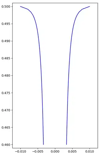

If the falling water column has cross-sectional area $A$ and speed $v$, the volume flow rate is $Av$. If the water is in free fall, it will have speed $v=\sqrt{2g(h_0-h)}$, where $h$ is the height of interest and $h_0$ is a height-like parameter that you twiddle to get the flow rate right at the tap. The constant volume flow rate gives $A\propto 1/v$, and you can plot the radius $r\propto \sqrt A$ to get the characteristic wide-at-top trumpet shape of water falling from a slowly-running tap.
plot: water profile falling slowly from a 2cm-diameter tap

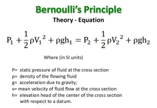

2.density of water remains the same at every point. Now, using Bernoulli's equation: enter image description here
Let us compare two points in the stream at different heights but near the edge of the stream. So, the pressure at both these points will be almost equal to the atmospheric pressure. So the pressure terms on both sides of the equation will cancel out. Now as the density of water remains constant throughout, ${\rho}_1={\rho}_2=\rho$. Now, the equation will look like:
$$\rho g h_1 + \frac 1 2\rho {v_1}^2=\rho gh_2 + \frac 1 2\rho {v_2}^2$$
So, you can clearly visualize that if $h_1\gt h_2$ then $v_1$ must be less than $v_2$ to satisfy the equation. The rate of flow equals $\frac{dV}{dt} = A\times {v}$. Where ${v}$ is the instantaneous velocity. Now, according to the theory of continuity, $${A}{v}=constant$$ So the rate of flow will remain constant since as the velocity is increasing, at the same time the area is decreasing.
