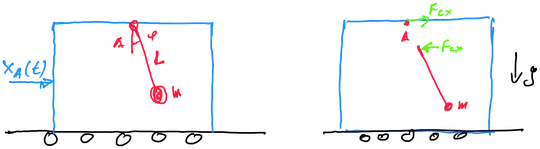

Consider the above scenario: In the subsequent motion, we need to find the work done by tension on the (trolley + mass) system.
Solution: Suppose at an instant, the velocity of the trolley (and hence that of point $A$) is $\vec{V_{a}}$, and the velocity of the point mass is $\vec{V_{b}}$. Then the power delivered by tension to the system is $\vec{T}\cdot(\vec{V_{b}}-\vec{V_{a}}$). Now, tension is always directed along the string, and, the velocity of the mass relative to point $A$, (i.e. $\vec{V_{b}}-\vec{V_{a}}$) is always perpendicular to the string. So the dot product is zero, i.e., the power delivered to the string is zero at all times. Hence, the tension does no work on the system.

For example, in your first scenario, which I can't really understand from the diagram, but lets consider a ball hanging from a string. If you push the ball in a direction parallel to the ground, the constraint force will make it go in a circular path. Now the question is, in which direction will you consider the displacement? If you consider it to be the circular path, then the tension will always be perpendicular to the displacement and therefore work done by constraint force will be 0. However if you notice, the circular path is a constant change in direction, and therefore not displacement in a fixed direction. So then let's consider another way of looking at the same scenario. What if we considered displacement to be parallel to the primary force, which is perpendicular to the string and parallel to the ground. Then after you push the ball, when the ball is displaced along the circular path, its path is no longer parallel to the direction of the primary force, the tension of the string will make it move up slightly, and it will also have a slight component parallel but opposite to the direction of the primary force. The tension then will do some work, and the value will change depending on which direction you consider the displacement and how far you push the ball. If you consider the displacement to be ‘up’ the tension will have a positive work done, and if you consider it to be parallel to the primary force, it will be negative. Furthermore we are not even considering the elasticity of the string, which can also factored into the work done by constraint forces. So the answer is that the work done by a constraint force is usually 0, but not necessarily, depending on the direction of the displacement you choose. But calculating the work done by considering the direction of the displacement to be perpendicular to the constraint force is usually the most meaningful and useful value, and so that is what is usually done.
According to D'Alembert's principle the constraints forces doesn't affect the motion of the system, to see it , you have to generate the equation of motion with generalized coordinate.
your example
The position vector to the mass
$$\vec R_m= \left[ \begin {array}{c} x_{{A}} \left( t \right) +L\sin \left( \varphi \right) \\L\cos \left( \varphi \right) \end {array} \right] $$
the velocity is $$\vec v=\vec{\dot{R}}_m=\underbrace{\frac{\partial \vec R}{\partial \varphi}}_{J}\,\dot{\varphi}+\frac{\partial }{\partial t}\vec{R}$$
$$J= L\,\left[ \begin {array}{c} \cos \left( \varphi \right) \\ -\sin \left( \varphi \right) \end {array} \right] $$
and the tension force is:
$$\vec T=T\,\vec{\hat e}_L=T\, \begin{bmatrix} \sin(\varphi) \\ \cos(\varphi) \\ \end{bmatrix}$$
thus D'Alembert's principle.
$$J^T\,\vec{T}=0~\surd$$
the Newton EOM's
$$m\,J^T\,J\,\ddot{\varphi}=J^T\left(\vec F_u-m\,\frac{\partial ^2}{\partial t^2}\vec R\right)+\underbrace{J^T\,\vec T}_{=0}$$ where
$$\vec F_u= \begin{bmatrix} 0 \\ -m\,g \\ \end{bmatrix}$$
$${L}^{2}\ddot\varphi +g\,L\sin \left( \varphi \right) + \left( { \frac {d^{2}}{d{t}^{2}}}x_{{A}} \left(t \right) \right) L\cos \left( \varphi \right) =0$$
the free body diagram show you that the constraint force $F_{cx}=T\,\sin(\varphi)$ is a internal force, only external force (applied force ) can do work
$$W=F_{cx}\,x_A(t)-F_{cx}\,x_A(t)=0~\surd$$
