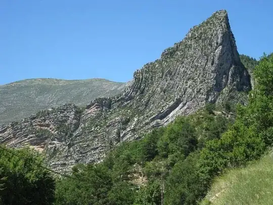

Large parts of the interior of the earth are solid when you look at them for a short time. If you bent a rock harder and harder over a period of say 100 years, it would break. This is why we get earthquakes. Mountains and other structures on opposite sides of a geologic fault move slowly past each other. They are jagged. Pieces press into each other. Forces build until something breaks. This clears the obstruction and everything moves suddenly.
But over geologic times, rock bends and flows smoothly.
Image from https://paintdigi.com/2018/02/10/beauty-of-the-mountains-folded-mountains-2/, credited to commons.wiki.org

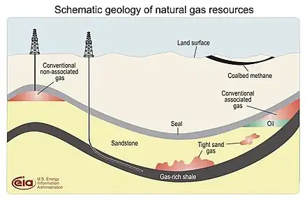

This applies to gas bubbles too. Most Helium on Earth is underground. It is slowly formed as radioactive materials such as uranium decay. Natural gas is found underground. It is formed as organic materials are buried and slowly decay and turn to oil. Sometimes these remain where they are formed. Sometimes they escape to the surface. And sometimes they are trapped underground on the way to the surface.
Image from https://en.wikipedia.org/wiki/Natural_gas

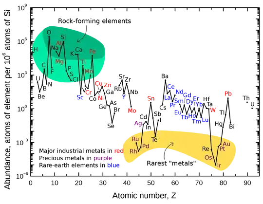

Update - Gold was a poor example of a denser element being more abundant in the core. It is true, but there is more to it than density.
The most abundant elements in the crust are light and/or abundant. According to this, the top 5 are in order oxygen, silicon, aluminum, calcium, iron.
The most abundant elements in the core are dense and/or abundant. They are guesstimated here as iron, silicon, nickel, sulphur, and chromium. There are no direct measurements of course.
Iron and silicon are everywhere. But the crust is 4% iron and the core is 85%. The crust is 28% silicon and the core is 6%. By and large, the denser elements did sink.
There are some special cases, and gold is one of them. As shown here, gold is especially rare at the surface.
Image from https://en.wikipedia.org/wiki/File:Elemental_abundances.svg
Most elements in the yellow band are rare at the crust because they mix well with iron. They followed most of the iron to the core. Gold is 0.001 PPM in the crust and 0.5 PPM in the core. There isn't much of it anywhere.
