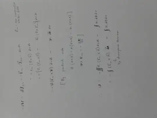

Actually the energy cannot come out of nowhere.In case of electrostat the energy was in the form of"BINDING ENERGY" that holds the system together, rather the charge configuration although the charges repel each other with tremendous amount of force. But in case of magnetic field there is no such thing. So where is the energy coming from? Now the magnetic field must grow in time to its final value from 0 along with the current. Now notice there will be a time varying magnetic field which will generate an non conservative electric field. This will perform negative work on moving charges in the current. This work done against the motion of charges trying to oppose the growth of current will be stored in the form of energy in the magnetic field. Remember the negative work would only be done by the "NON CONSERVATIVE " electric field (not by the conservative as the conservative field drives the charges) only on the "FREE CHARGES" against the free current (NOT ON THE BOUND CURRENT BECAUSE BOUND CURRENT ISNT CARRIED BY CHARGES) So the energy growing in small time dt in a small elemental volume dv is given by enter image description here

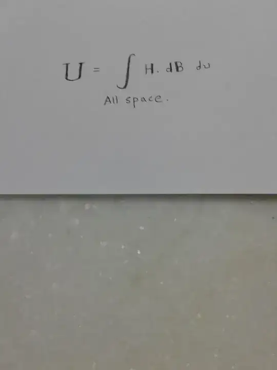

Now this is for some volume and enclosed surface area for it. Now as we increase the volume towards infinity then all the E and H fields will tend to 0. So for all space integral the surface integral goes to 0. So this is what remains.enter image description here
Therefore we may consider energy stored per unit volume as H.dB integral over its time growth.Look, that this depends on how B has grown with H. In free space since there is no magnetization B=uoH and so energy density is B^2/2uo. But for linear isotopic homogeneous diamagnetics it is B^2/2u and for magnetic core it is the AREA UNDER H-B HYSTERESIS CURVE. The energy may be "stored" in "free" as well as "bound" current distribution although it is generated by the negative work on "free" currents only. BUT, when all currents are removed or diminished the energy is gradually or quickly LOST AS HEAT.this results in hysterisis loss and heat generated in RL DECAY CIRCUIT.
