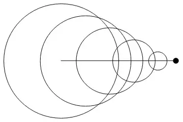

Consider a set of the wave crests (the pressure maxima) from a beeping object that has moved through a two-dimensional medium at twice the speed of sound. They make up circles that intersect at the points that expand out away from the trajectory of the object. At first it indeed looks like the maximum pressure increase could be 2×, not unlimited as in the case of motion exactly at the speed of sound.

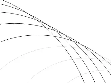

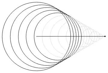

As the time passes, these points expand out, but remain on the same lines, with the lines being at the same distances from each other. At the same time, the radii of the circles increase, and their curves become straighter. In the following image the black circles represent further evolution of the ones shown above, while the gray ones are the wave crests generated after the black ones.
If we zoom in the upper part of the black circles, we'll see that their curves (the wave crests) concentrate near their intersections due to becoming straighter. This effectively means that our constructive interference now happens not only at the points of intersection, but also in their neighborhoods.

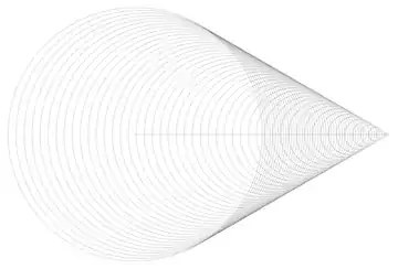

When the circles expand out much more, you can see that they, due to concentrating, form a nearly solid line.
In 3D, this corresponds to the spheres of wave crests expanding out to form a solid cone. This solid cone is the very shock wave that one can hear as the sonic boom.
