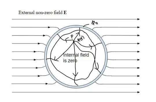

Now your main question. How do we know that the electric field inside the cavity (which is not part of the metal) is zero. We can answer this question by showing that the potential energy inside the cavity has gotta be constant and equal to $\phi_0$.
Pick any point, $P$, inside the cavity. We prove that the potential of this point $\phi(P) = \phi_0$ by contradiction. Assume first that $\phi(P)>\phi_0$ ($\phi(P)<\phi_0$). Then look at the paths connecting this point to the surface. As we move along any of these lines, the potential changes from $\phi(P)$ to $\phi_0$, hence on all these lines there must be regions where the electric field is points outwards (inwards). This however cannot be true. Since if we looked at a surface that connect all these regions, the surface integral of the electric field is not zero, which from $\vec{\nabla}\cdot E = \rho/\epsilon_0$ means that the region contains electric charges, which we know is not true. We must then conclude that $\phi(P) = \phi_0$. But $P$ can be any point really, so all the points inside the cavity must have potential of $\phi_0$. Hence the electric field is zero inside the cavity.
Edit (1): Elaboration on the method.
Allow me to maybe explain this better. I'd actually wanna know if this doesn't hold water. For any point $P$ inside the cavity consider a sphere surrounding that point. For our proof by contradiction let's focus on the assumption that $\phi(P)>\phi_0$ first. For each point on the sphere we ask what is the gradient of $\phi$ at this point. If the gradient is pointing inwards we do noting. However if the gradient is pointing outwards or zero we do the following. We connect the point $P$ to that point on the surface with a straight line, and further extend this straight line until it reaches the metal. Now since $\phi(P)>\phi_0$ somewhere on that line the gradient of $\phi$ must be pointing towards $P$ and away from the metal. So what we do is deform the sphere such that it intersects the line at this point. Then we repeat this process for each point on the surface. The resultant surface would be a surface that has the gradient of $\phi$ pointing inwards at all points, hence the electric field pointing outwards at all points. Thus the surface integral of the field would be non-zero. This would mean there must be some enclosed charge, and hence the contradiction. This would mean that $\phi(P)$ cannot be bigger that $\phi_0$. We can do the same thing if $\phi(P)<\phi_0$. Thus $\phi(P)$ can only be equal to $\phi_0$.
