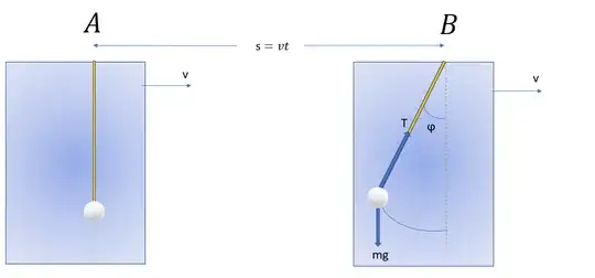

  1. There is a pendulum in a car, both car and pendulum are at rest. Till now, tension forces appear as if they never do any work on the mass (if displaced slightly). Now, the car starts moving. For the mass to follow string constraint it must also move forwards. The displacement of the mass no longer remains perpendicular to the tension. Hence, tension does work in this situation.

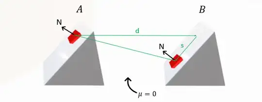

  1. Another such popular example is the work done by Normal force acting on a block placed on a movable inclined wedge, both free to move, over a journey from A to B. Here, Normal does not do any work on the mass(if allowed to slide through a distance), when the wedge is at rest, but the movement of wedge forces normal to do work. For any displacement of the mass relative to the wedge the work done by normal is zero. But, the wedge is also moving.
I just wanted to know whether we could have some nice simplification of the formula $$W_{F} = \int_{A}^{B}\mathbf{F}\cdot\text d\mathbf{s}$$ in order to find the work done by such forces when the "vehicle" is also in motion.

Let's have a look at the problem $1$ stated in the question. We need to find the work done on the mass by tension force in the journey from $A$ to $B$.
Now, the small displacement of the block $d\vec{s}$ can be resolved in two parts, first due to motion of car (say $d\vec{s_c}$) and second due to the circular motion of the mass around the pivot (say $d\vec{r}$). The expression of work done by tension, becomes $$W_{T}=\int_{A}^{B}\vec{T}\cdot d\vec{s} = \int_{A}^{B}\vec{T}\cdot d\vec{s_c}+\int_{A}^{B}\vec{T}\cdot d\vec{r}$$
But, Tension is always perpendicular to $\vec{dr}$. Hence, $$W_{T} = \int_{A}^{B}\vec{T}\cdot d\vec{s_c}$$

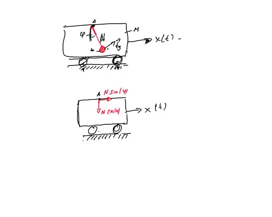

The work that done by the normal force N is:
$$W=\int N\,sin(\varphi)\,dx=\int N\,sin(\varphi)\,\frac{dx}{dt}\,dt$$
with:

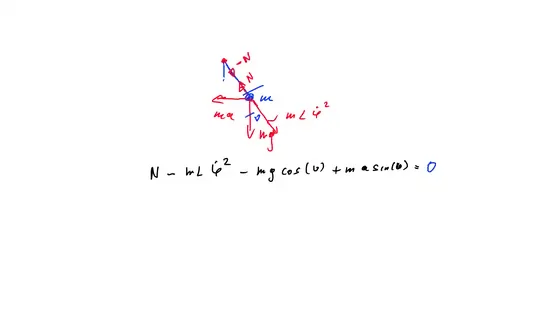

$$N=-m\,\left[\cos(\varphi)\,g+L\dot{\varphi}^2-a\,\sin(\varphi)\right]$$ $$\dot{x}=a\,t$$
you obtain: $$\dot{W}=N\,\sin(\varphi)\,a\,t\tag 1$$
to obtain the result $W(t)$ you need the equation of motion for the pendulum which is:
$$\ddot{\varphi}+\frac{g\,\sin(\varphi)+a\,\cos(\varphi)}{L}=0\tag 2$$

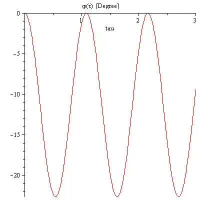

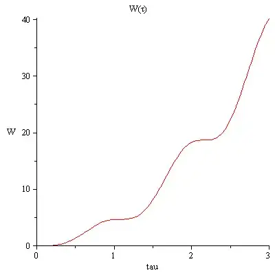

Simulation :
Edit
Normal force
