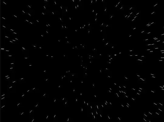

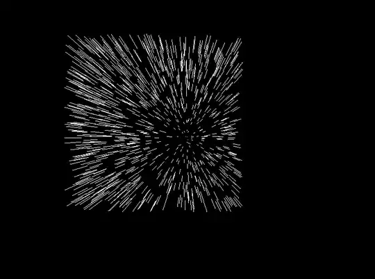

Here's some screenshots from simulation I made while thinking about this.
Point chosen as E is not in the epicenter (which is the middle of the square, it's a square because I chose random velocities by choosing random horizontal and vertical component independently, distribution just influences point density, not observed recessional velocities at t0). Lines illustrate recessional velocities.
And here's exactly the same system just a bit later. You can no longer tell that you are not in the epicenter because you can't see far enough in all directions.

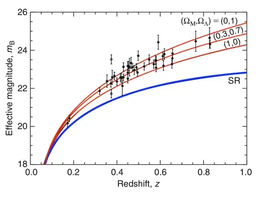

However, remember that we don't actually measure the velocities $v$ of galaxies. We measure their redshifts $z$, and we then convert that to a velocity, given our GR model. In an SR model, the relation between velocity and measured redshift is different (I can provide the equations if needed). Combining the velocity-redshift relation $v(z)$ with the Hubble law, you then get a distance-redshift relation $d(z)$. This relation, in turn, can be combined with the knowledge of how the flux, or the observed magnitude, of a luminous object decreases with observed redshift, $m(z)$.
In GR, $m(z)$ depends on the densities of the different components of the Universe (matter and other forms of energy), whereas in SR, it only depends on the velocity, and hence distance.
The figure below (slightly modified from Davis & Lineweaver (2004)) shows the magnitudes of a set of supernova (Perlmutter et al 1999), as a function of their measured redshift. The three red lines show three different versions of the GR model, with different densities of matter and dark energy. The best-fitting model (middle line) has roughly 30% matter and 70% dark energy, while the two other lines show less well-fitting models of pure matter (lower line) and pure dark energy (upper line).
On the other hand, the blue line shows the SR prediction. This interpretation is ruled out at a confidence level of $23\sigma$!
davis23sigma
