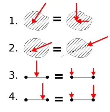

First we look at two rules that students of mechanical engineering (I don't know about physics) learn at university:
  1. Multiple forces applied to the same point of a solid body have the same effect as a single force applied to that point whose magnitude and direction is the same as the the vector sum of the other forces. (See pos. 1 in my image.)
  2. A force applied to some point of a solid body has the same effect as a force with the same direction and magnitude applied to another point of that body along the same axis. (Sorry, my English is not the best. But pos. 2 in my image should make this clearer.)
In university, these two rules are used to prove that the formula of momentum ($M = r\times F$) is valid...
However, we can use the same methods used in that proof to prove that a body will rotate if the force is not applied to the center of gravity:

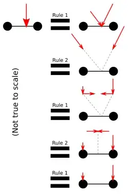

We do that for a very simple body because otherwise we would require integral calculation: We have a body like a dumbbell: Some bar that has nearly no mass in the middle but all mass is concentrated in the two endpoints. (Pos. 3 and 4 of my image)
We do some vector calculations (shown in my second drawing) to prove that one force applied to some point of the body has the same effect as two forces applied to the ends of the body (where the mass is).
If the single force is applied to the center of the bar (if both masses at the ends are equal, this is the center of the mass), the two forces having the same effect as the single force have the same magnitude. (Pos. 3)
However, if the single force is not applied to the center of the bar, the two forces do not have the same magnitude. (Pos. 4)
You may say that the left force accelerates the mass on the left end of the bar while the right force accelerates the mass at the right end of the bar.
Because the forces have a different magnitude (but the masses are equal), the acceleration is different and therefore the velocity will be different after a short time.
If two points of a solid body move with a different velocity, this means that the solid body is rotating.

Positions 1-4 in my answer:
Vector operations required for the proof:

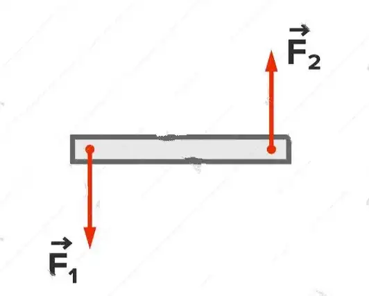

This can be explained with a simple case - torque with zero net force.
Consider a rod in free space being acted upon by two equal and opposite forces at the ends.
The subsequent motion of the rod is dictated by -
  1. No net force on the COM
  2. The rod is a rigid structure
What it means is individual particles of rod must move without changing their relative positions (the rod is rigid) and also the COM of the rod must not accelerate (the net force is zero).
That leaves a single way - rotation about the COM.
